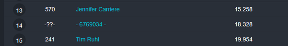

  2. Dissociation between Transponders/User: This one affects me and is a pet peeve, but also affects many other people. Basically, a users transponder pings just fine and its logged in the database, but the backend MyLaps software can’t/won’t associate the transponder number with a user. Below is an example with my transponder. If I look up my times by transponder number everything is there, if I look it up by my name or plate number the timing information is missing. It’s also not consistent. For some reason it only happens to me during Friday Practice and Endurance; and it’s every Friday. Saturday and Sunday are always fine. Again, this is a MyLaps/Orbits software issue, not a transponder issue. The other big issue is wrong names are sometimes associated with transponders which also is illustrated below. 570 should be Dave Minnett.

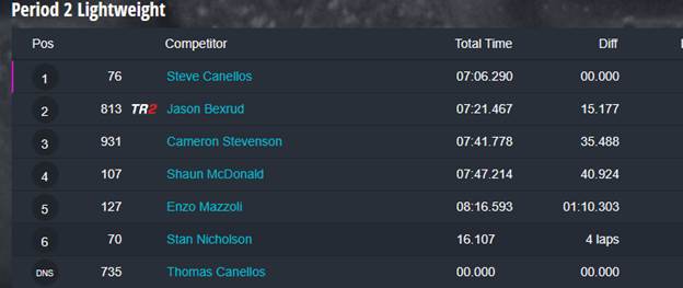

  3. Timing loop issues and Bike Collection: This is primarialy a Mosport issue. When bike pickup collects a bike and they haul it back over the timing loop when exiting the track - it pings. Thus it appears as though the user has finished the race. A good example of this was at Mosport last year where Stans bike stopped on the grid and he parked it, but was still credited with a finish instead of a DNS or DNF when the bike triggered the timing loop from the bike pickup trialer. He was honest enough to let me know.

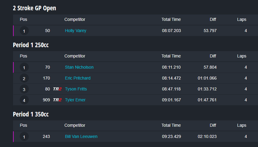

  4. Orphaned Race results: This is by far the biggest and hardest problem to deal with. Results show up in the wrong class/heat/race or dont show up at all. Here is a great example. These are the results for Middleweight Production, P1-500 and P1-250 from Mosport in 2025, however It also includes Holly Varey’s result indicated as 2 Stroke Open which was 3 races before and Bill Van Leeuwen’s indicated as P1-350 from 4 races later. Their results are missing from their proper races. Also, P1-250 was won by Dean StCroix and Holly Varey was second, but it shows Stan won and the results make no mention of Dean or Holly in P1-250. Again, Stan was honest enough to point this out to me.
